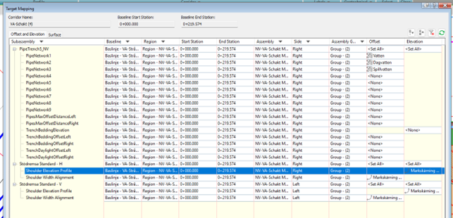

Once the corridor is set up, add the necessary targets—pipe network and surface targets.
Use the Export Corridor function to extract daylight lines from the corridor. These feature lines will be put back into the corridor as targets for the superstructure, specifically for the shoulder elevation profile and shoulder width alignment profile settings.

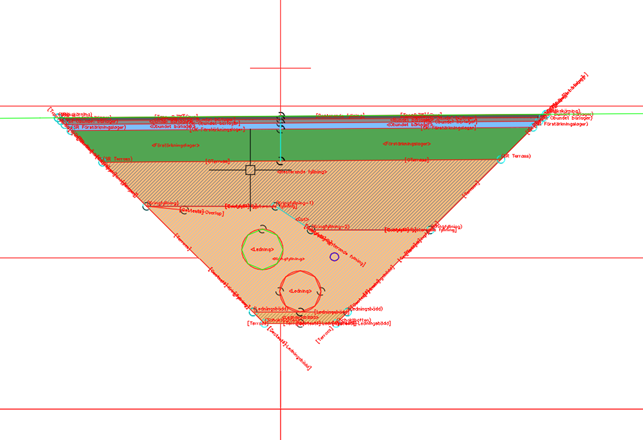

Infra Blog 2
When the correct targets are set, the corridor section should look something like this.

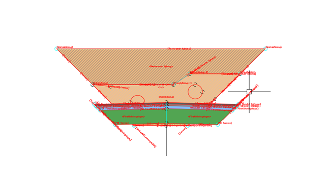

Avoiding Overlaps in Volume Calculations
Overlapping volumes between the pipe trench and the superstructure can lead to inaccurate results. The solution? Create two new corridor surfaces:
  • Upper surface: the lowest point of the superstructure link – displayed as the magenta line in the section below
  • Lower surface: the highest point of the pipe trench – displayed as the blue line in the section below

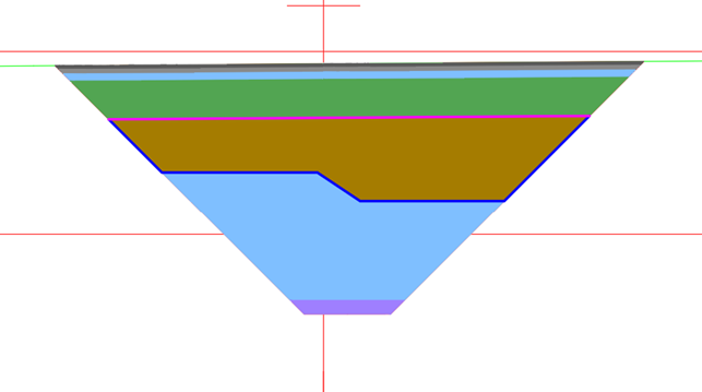

This setup enables precise volume calculations between the two surfaces. Naviate 26.2 introduces a new take-off criteria called "Pipe trench with superstructure"—available upon request if you're not yet using this version.
Apply the criteria using the Compute Materials function. Once the surfaces are defined and the criteria is active, you'll get a clean material list showing only the volume between the trench and the superstructure, highlighted as brown in the image below:
Infra Blog 4
