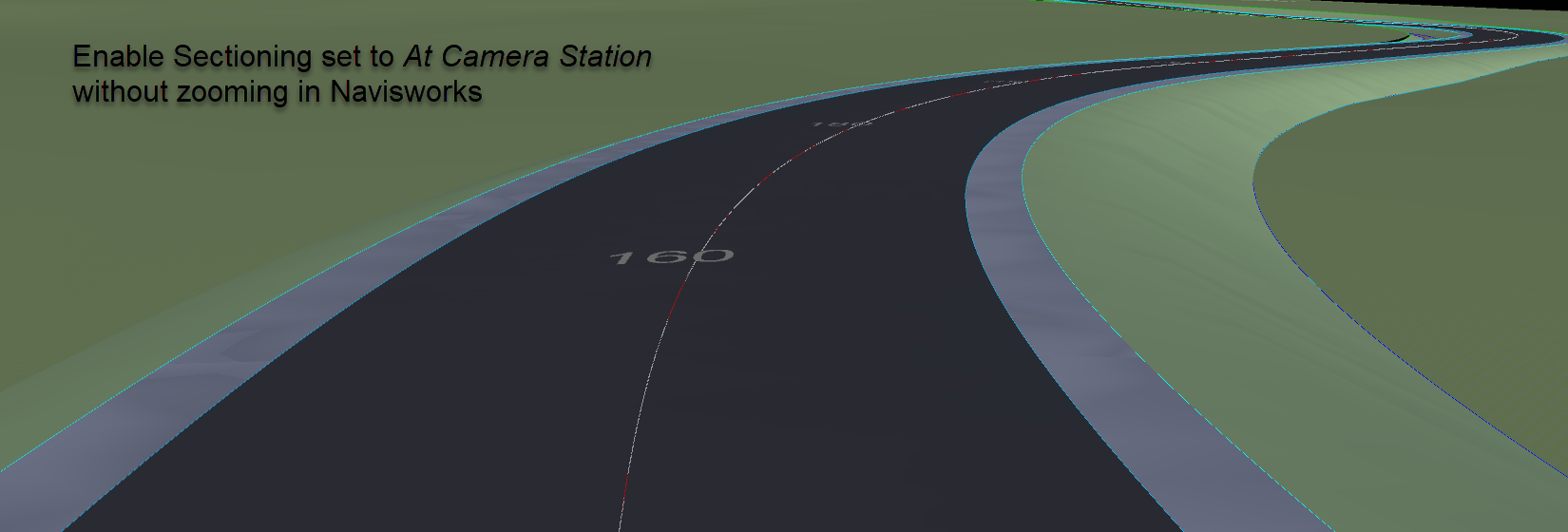

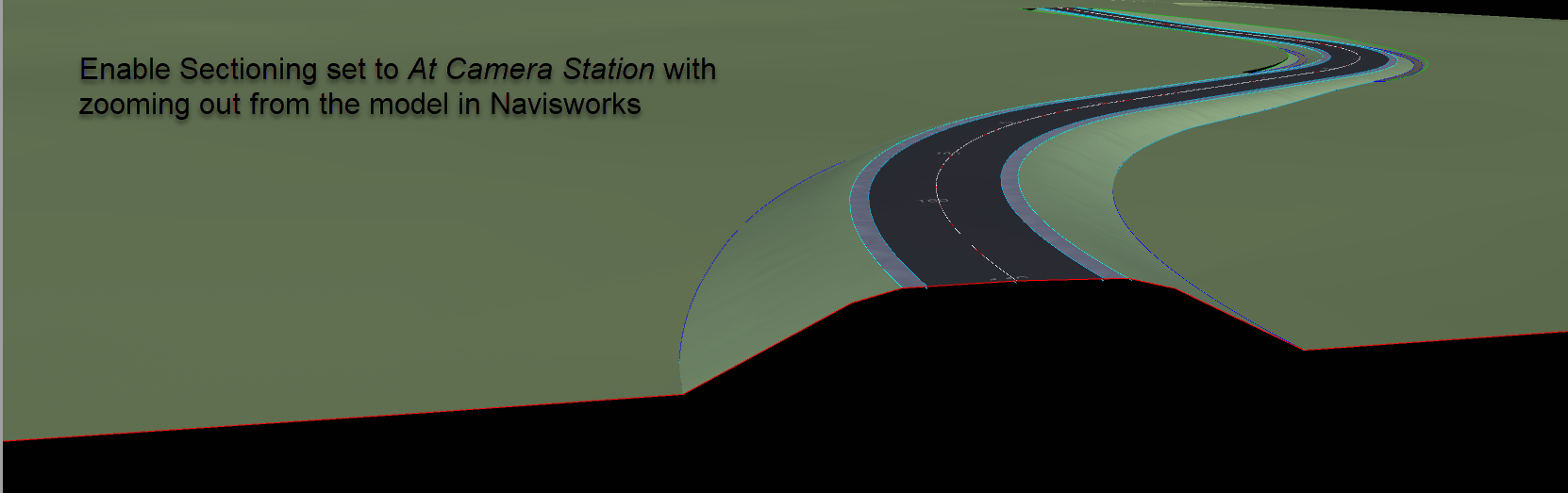

If you set Enable Sectioning to At Camera Station, the sectioning in Navisworks will be at the exact same station as the camera. The section won’t then be visible until you zoom or change the view in Navis. Of course you can use the Station Adjustment value to view your Camera Station at a distance.
Enable Sectioning set to At Camera Station without zooming in Navisworks
Enable Sectioning set to At Camera Station with zooming out from the model in Navisworks
