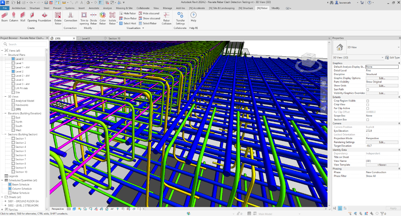

In this latest Naviate Rebar discovery session we take a look at our new feature, Rebar Collision, which checks for reinforcement clashes.
Rebar clashes can cause serious issues on site and becomes a huge problem with large diameter bars with dense, complex arrangements. The clashing bars cannot simply be moved to another location as this often causes issues in other areas. Of course, having a 3D model helps to find the clashing rebar but this is still a manual task.

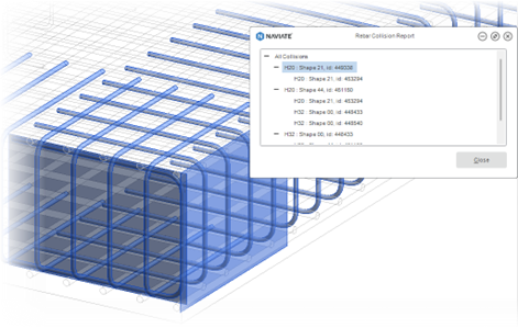

The new Rebar Collision tool allows detailers to quickly locate clashing bars directly in Revit. You can preselect the rebars or select the host elements. Once the Rebar Collision has executed a Rebar Collision Report is displayed. The hierarchical report is organised so the user can select all collisions at the top of the tree or colliding rebars in specific groups. Individual rebars can then be selected for a full understanding of the clashing rebars.
As the collisions are selected in the Rebar Collision Report dialog, the rebars are selected and the active view will be zoomed to the extents of the colliding rebars.

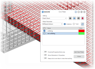

When clashes are detected, two parameters are also written into the colliding rebars which allows further analysis and inspection of rebar clashes. In the below example you can see the Colour Rebar tool being used to inspect and select colliding rebars.

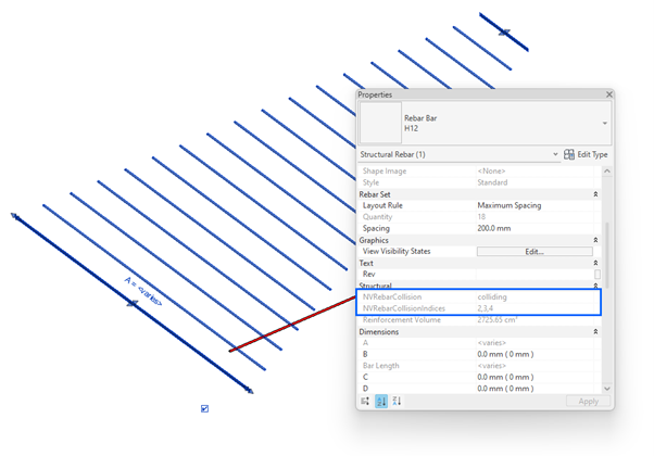

When working with larger rebar sets or varying rebars there may only be a few bars within the set that are actually colliding.
In the example below a single rebar is colliding with a varying range of rebars. Only three of the bars are colliding and this is also reported in the NVRebarCollisionIndices parameter. In this case bars 2,3 & 4 are colliding.
