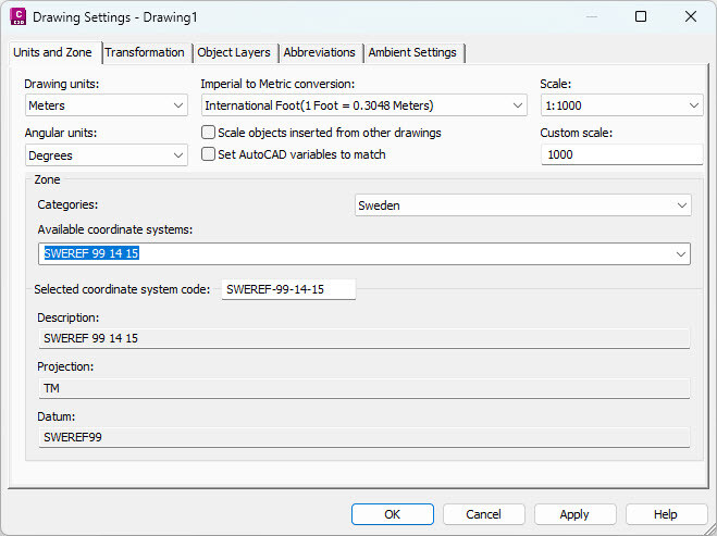

The first step is setting the coordinate system in your existing file. You do this through Drawing Settings (DRAWINGSETTINGS or right-click on the drawing name in the Tool Space/Settings tab). Enter the coordinate systems, Units, and Zones on the first tab. Then, close the file.
EditDrawingSettings
Open a new file and set the coordinate system you want to transform to in the Drawing Settings in the same way as in the existing file.

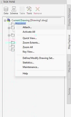

  1. Open the MAP Task Pane, easiest by typing the command MAPWSPACE and setting it to On.
  2. Go to the Map Explorer tab in the Task Pane, right-click Drawings, and select Attach.(If you don’t get a dialog box, it's because a search path is missing in Options. Scroll down for more information on how to solve this.)
    MapTaskPane
  3. Locate the file that you want to transform. Click Add, and then click OK. The drawing should now be under Drawings in the Map-pane. If the icon in front of the drawing is light gray; right-click and select Activate.

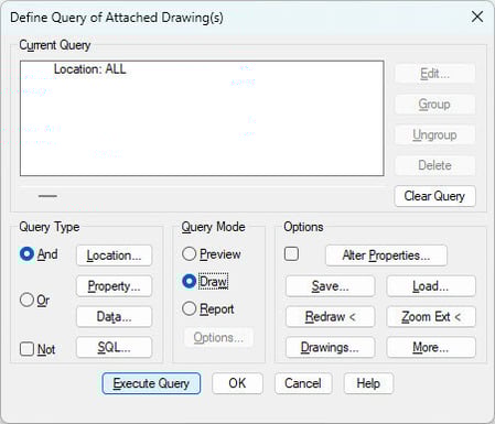

  4. Return to the Task Pane, right-click Current Query (under Query Library), and select Define.
    Query
  5. Click the Location button, select All, and OK.
  6. Check the Draw option and, finally, click Execute Query. If nothing happens and the dialog box at the bottom says, "Query source is not available or empty," right-click on the drawing in the Map Pane and choose Activate. Then, redo the Query part.

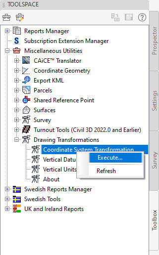

  2. Then go to Toolbox on the Toolspace panel, under Miscellaneous Utilities > Drawing Transformations > Coordinate System Transformation. If it is unavailable, you need to download the extension from the Autodesk Manage Portal.

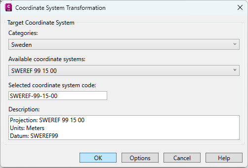

  3. In the dialog, select the destination Coordinate system and click OK.
    transformation
  4. The system will transform everything and display a transformation report.
